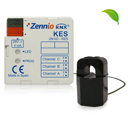

I would like to try do this :
A KNX power consumption ...
Web page http://www.zennio.com/produits/knx-compteur-energie/kes
