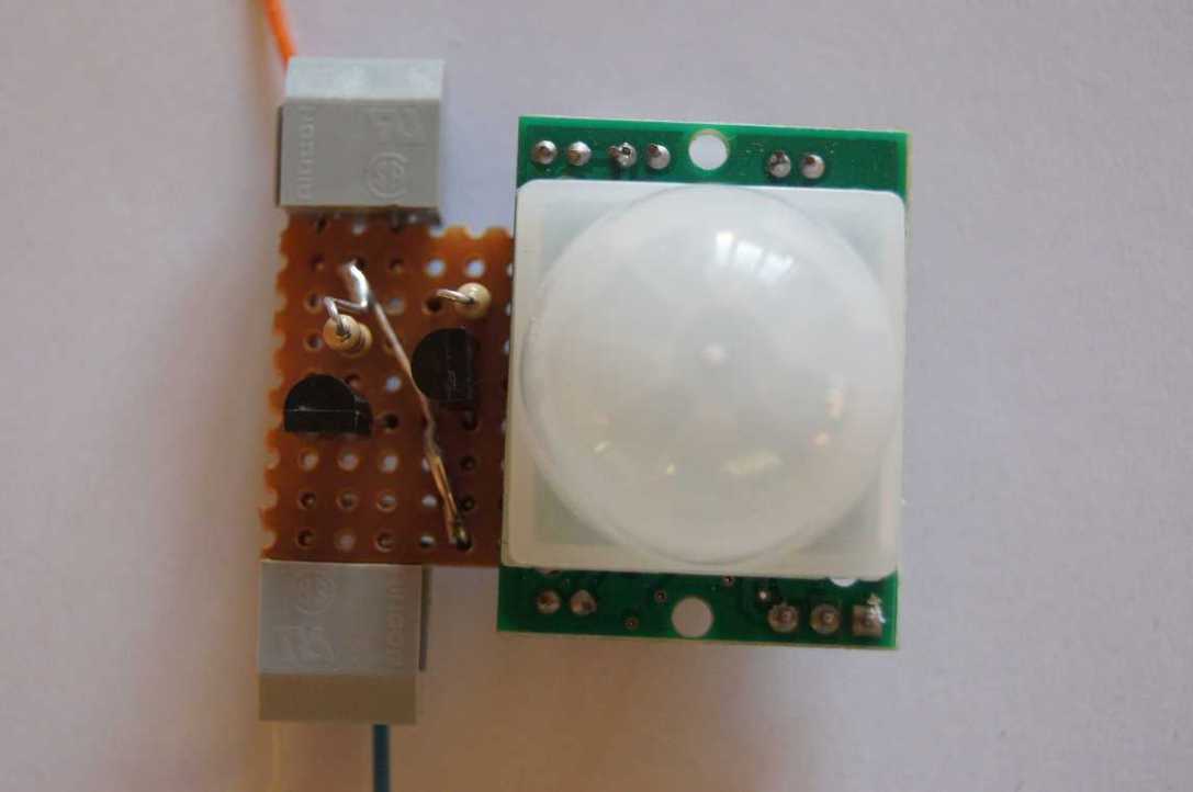

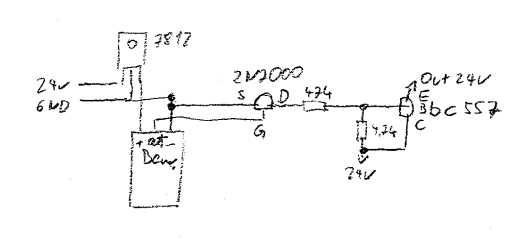

Mit folgender Schaltung habe ich die 5V out 24V verstärkt.
schaltung.jpg [ 8.86 KiB | 1471-mal betrachtet ]

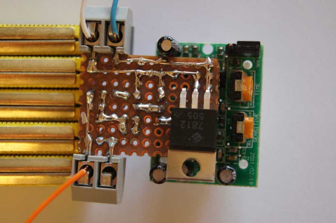

Und wie folgt auf Lochraster aufgebaut
DSC02038a.jpg [ 85.5 KiB | 1471-mal betrachtet ]
DSC02037a.jpg [ 112.65 KiB | 1471-mal betrachtet ]
Die Ausschaltverzögerung habe ich so auf 30s eingestellt. Der Anschluß ohne Kabel wollte ich eventuell als Sabotagekontakt verwenden.

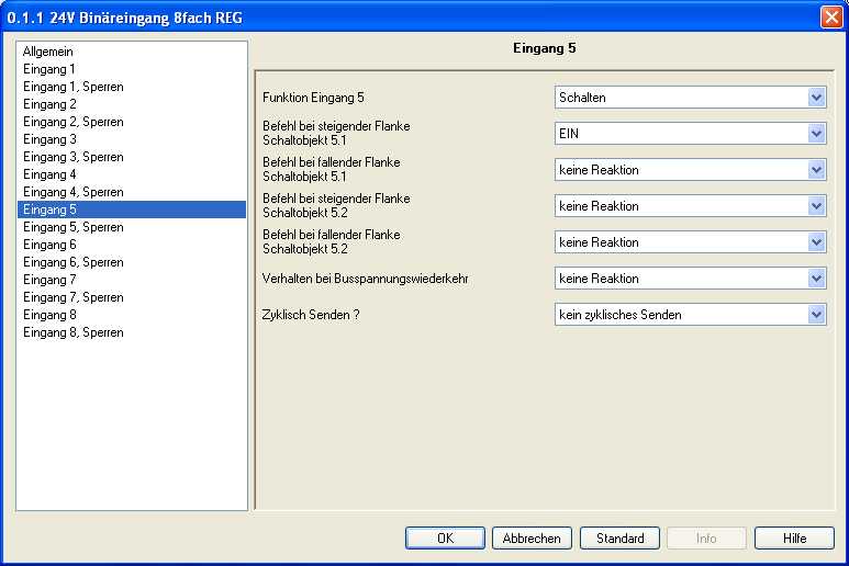

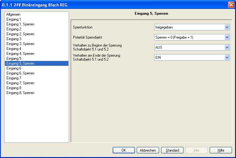

Der 8in ist wie folgt zu konfigurieren: Das Sperrobjekt kommt vom Kombisensor
5.jpg [ 40.26 KiB | 1470-mal betrachtet ]
5sperre.jpg [ 33.63 KiB | 1470-mal betrachtet ]
Viel Spaß beim Nachbauen

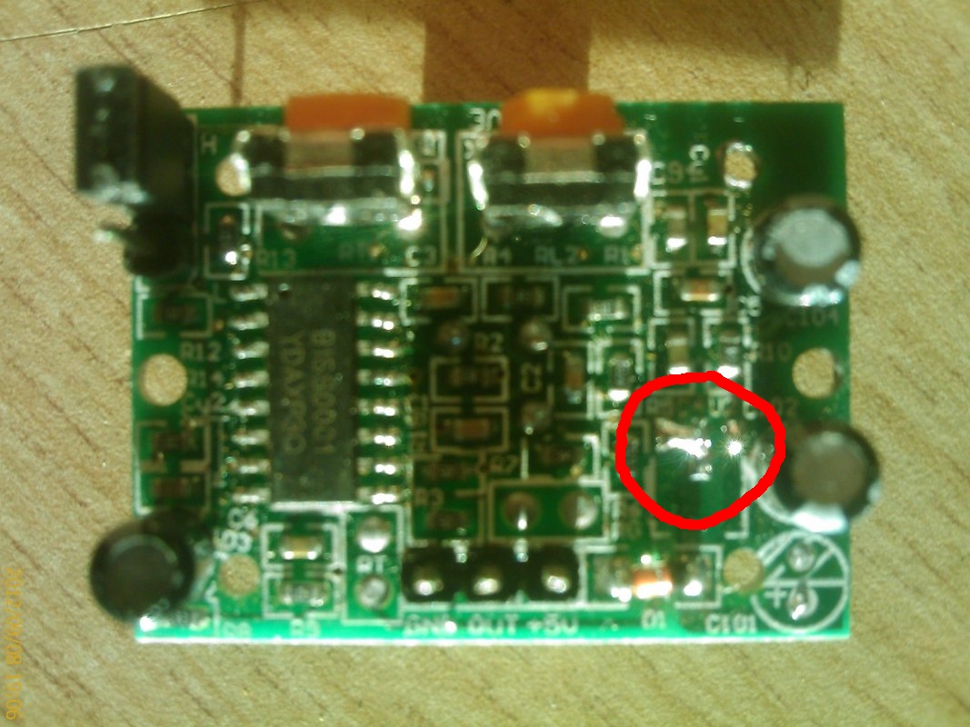

Hello,
These are nice small PIR sensors that are easy to hide away. I have 4 of them for a while now. Today I needed one and found out that these sensors have voltage regulator of 3,3V (input 4,5 to 20V). Since I'm going to use the tasterschnittstelle for a interface, I have a 3,3V power supply. I removed and bridged the voltage regulator on the sensor like shown on the picture. Simply connect the 3 wires (VCC, GND and Taster1) and ready, I thought.
I found out the sensor switches on and off unintended continually. I think it is the same problem I had before when I used the LPC controller power supply to power a DCF77 receiver, the LPC power supply is not clean. I do not have a oscilloscope to test this, but I'm nearly sure this is the problem...
Can we fix this problem? It would make the LPC controllers a LOT more universal if we could use the power supply without problems like these

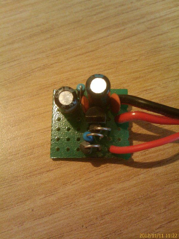

Today I have found my way to make this little motion sensor work.
I made a small power supply for the sensor based on this design:
http://www.electronicecircuits.com/elec ... wer-supply
I don’t know if it is necessary for such a elaborate power supply, however, it does work perfect now.
I connected the input for the power supply just behind the 150mH inductor.
I used a tasterschnittstelle as interface, and simply connected the output from the motion sensor to one of the tasterschnittstelle inputs.
Have fun
